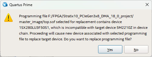

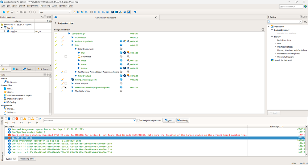

Thank you for your reply, FvM.
After selecting the device "1ST280EY2", I have a pop-up warning with the message below:
I'm wondering why the message showed up. I already modify the Instance with Stratix 10:1ST280EY2F55E1VG. But, the compiled stuff has the device of 1SX280LU3F50S1.
Can I know how to change the device name in the project?
