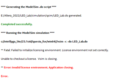

2 years agoFailed to initialize licensing environment. License environment not set correctly.
I am having an issue setting up the Questa Intel FPGA sim license for my Quartus Prime Lite 23.1 installation. I have installed my license per the Intel instructions, but I get the following error m...
- 2 years ago
Make sure LM_LICENSE_FILE in your environmental variables is pointing to the .dat.
