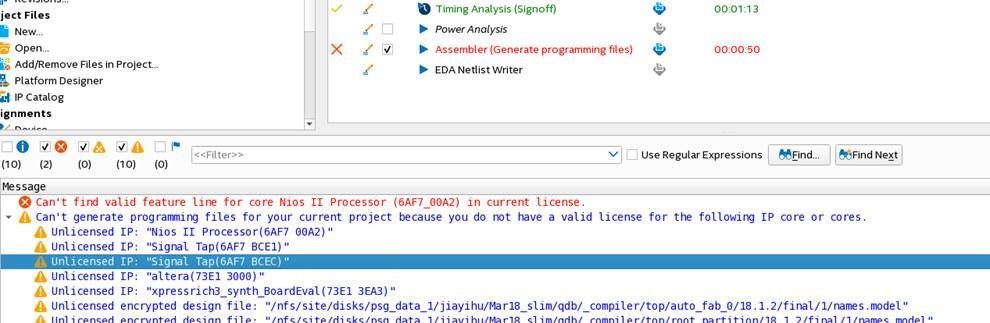

Failed to generate sof with error: Unlicensed IP: "Nios II Processor(6AF7 00A2)"
I failed to generate sof with Nios + PLDA rich3. But I can generate sof which only include Nios or PLDA.
I use Quartus version 18.1.2,
Error shows:

      I do have Nios license. And when running assembler, quartus will require twice with 1 successful and 1 unsuccessful.
      ; Assembler Encrypted IP Cores Summary ;
      ; Vendor ; IP Core Name ; License Type ;
      ; Altera ; Nios II Processor (6AF7 00A2) ; Unlicensed ;
      ; Altera ; Nios II Processor (6AF7 00A2) ; Licensed ;
      ; Altera ; 16550 UART (6AF7 010C) ; Licensed ;
      ; Altera ; Signal Tap (6AF7 BCE1) ; Unlicensed ;
      ; Altera ; Signal Tap (6AF7 BCE1) ; Licensed ;
      ; Altera ; Signal Tap (6AF7 BCEC) ; Licensed ;
      ; PLD Applications ; altera (73E1 3000) ; Unlicensed ;
      ; PLD Applications ; xpressrich3_synth_BoardEval (73E1 3EA3) ; Unlicensed ;
