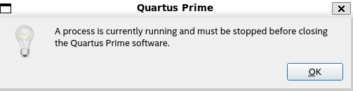

I am running Quartus GUI on a Linux server remotely through an SSH session.
One of the below two issues happens 50% of the time after starting compilation
  1. Quartus hangs during a stage of compilation showing as if it is working (timer is increasing) but nothing is happening and no substantial CPU usages is observed. Trying to stop compilation fails and attempting to close the project fails giving the below message:
