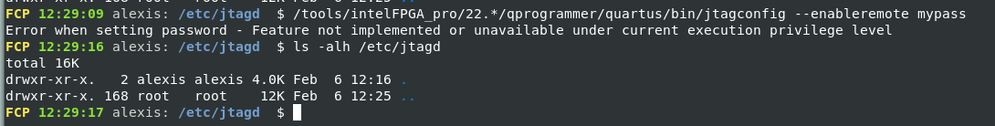

jtagconfig to run jtagd: Error when setting password - Feature not implemented or unavailable under current execution privilege level

    As you can see in the screenshot, the password is provided "mypass".
    Then, why do I get this error message?

    You run --enableremote on the machine you want to act as the JTAG server, setting the password that others will use to connect to it. On other machines that want to connect to this machine as a server, they use --addserver, setting the address of the server and the password that was set.
    As for the error, perhaps you have to run it as sudo.

      @sstrell That's exactly what I've done. There is no valid reason to run any of the jtag* commands as root.
      After trying again and again after reboots and all, it has stopped returning this error.
      It would still be good to know why I got this error message.

    You need to run it in administrator mode to avoid the error.
