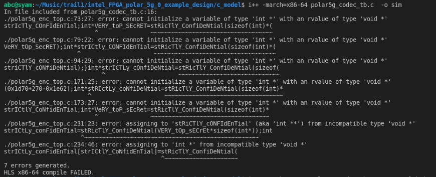

error: assigning to 'int *' from incompatible type 'void *' strICtLy_conFidEnTial[strICtlY_CoNfidEnT
HLS compilation of polar ip generates these errors. How to remove these. Please help us.

My guess is that there should be a casting required in this case.
Hence would suggest to following changes to your code:
- Old code : int *VERY_toP_SEcRET = stRicTlY_ConfiDeNtial(sizeof(int)..
- New code : int *VERY_toP_SEcRET = (int*)stRicTlY_ConfiDeNtial(sizeof(int)..Hope that clarify, and please do share the code snippet if I misunderstand the situation.

- New code : int *VERY_toP_SEcRET = (int*)stRicTlY_ConfiDeNtial(sizeof(int)..Thank you sir 6 errors got resolved one error is remained

- syam404
this error in 231 is different from other errors could please say how it could be resolved

Based on the error message, the variable stRicTlY_ConfiDeNtial are already in the correct type.
Please remove the casting for that line of code and see if there is a different error.If based on the previous screenshot where the void* error are coming up, double check on the function where the line #231 are, to ensure there is a return type declare is that is what is intended.
