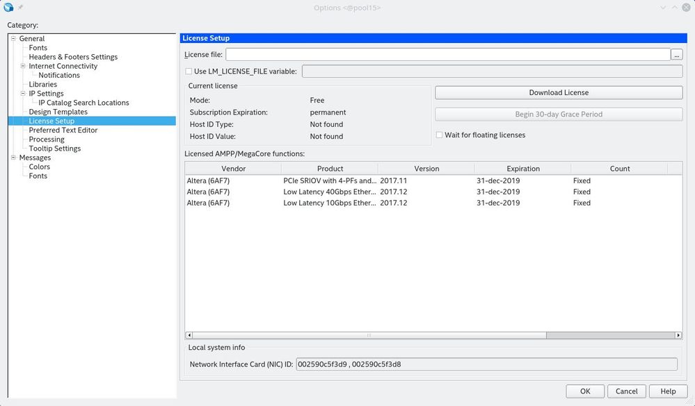

    where can i get a new "Free" License for Quartus® Prime Pro Edition 17.1.1:
    Warning (115003): Can't generate programming files for your current project because you do not have a valid license for the following IP core or cores.
    Warning (115005): Unlicensed IP: "PCIe SRIOV with 4-PFs and 2K-VFs(6AF7 00FB)"
    Warning (115005): Unlicensed IP: "Low Latency 10Gbps Ethernet MAC(6AF7 0119)"
    Warning (115005): Unlicensed IP: "Low Latency 40Gbps Ethernet MAC and PHY(6AF7 011B)"
    Warning (115004): Unlicensed encrypted design file: "/opt/inteldevstack/a10_gx_pac_ias_1_2_pv/opencl/hello_world/bin/hello_world/build/qdb/_compiler/afu_fit/root_partition_2cedade0/17.1.1/final/1/netlist.model"
    Warning (115004): Unlicensed encrypted design file: "/opt/inteldevstack/a10_gx_pac_ias_1_2_pv/opencl/hello_world/bin/hello_world/build/qdb/_compiler/afu_fit/root_partition_2cedade0/17.1.1/final/1/names.model"
    Warning (115004): Unlicensed encrypted design file: "/opt/inteldevstack/a10_gx_pac_ias_1_2_pv/opencl/hello_world/bin/hello_world/build/qdb/_compiler/afu_fit/root_partition/17.1.1/final/1/netlist.model"
    Warning (115004): Unlicensed encrypted design file: "/opt/inteldevstack/a10_gx_pac_ias_1_2_pv/opencl/hello_world/bin/hello_world/build/qdb/_compiler/afu_fit/root_partition/17.1.1/final/1/names.model"
    Simon

    As of 01/01/2020 the following have become Unlicensed with the Acceleration Stack Version 1.2.
    ; Assembler Encrypted IP Cores Summary ;
    ; Vendor ; IP Core Name ; License Type ;
    ; Altera ; PCIe SRIOV with 4-PFs and 2K-VFs (6AF7 00FB) ; Unlicensed ;
    ; Altera ; Low Latency 10Gbps Ethernet MAC (6AF7 0119) ; Unlicensed ;
    ; Altera ; Low Latency 40Gbps Ethernet MAC and PHY (6AF7 011B) ; Unlicensed ;
    ; Altera ; Signal Tap (6AF7 BCE1) ; Licensed ;
    ; Altera ; Signal Tap (6AF7 BCEC) ; Licensed ;
    4315 Info (16677): Loading final database
    4316 Warning (292015): License for core 6AF7_0119, version 0000.00 is expired.
    4317 Warning (292015): License for core 6AF7_00FB, version 0000.00 is expired.
    4318 Warning (292015): License for core 6AF7_011B, version 0000.00 is expired.
    According to the documentation "You do not need to purchase the license separately for these IPs."
    Please advise ASAP to what is required to get a new license?
