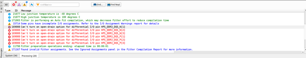

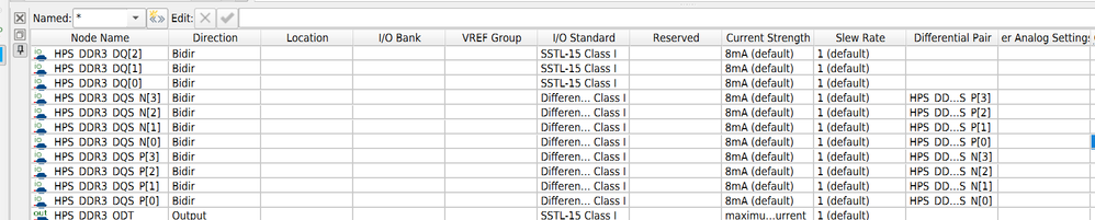

Error (169008): Can't turn on open-drain option for differential I/O pin HPS_DDR3_DQS_N[1]
Hello.
Please, suggest how to resolve this error. Quartus 25.1, Cyclone V,  Start Fitter.
inout [3:0] HPS_DDR3_DQS_N,
inout [3:0] HPS_DDR3_DQS_P,
.memory_mem_dqs (HPS_DDR3_DQS_P), // .mem_dqs
.memory_mem_dqs_n (HPS_DDR3_DQS_N), // .mem_dqs_n
