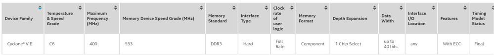

  • BoonT_Intel's avatar
    BoonT_Intel
    Hi, Don't tick anything under the "Interface I/O Location". This section should be ignore as it only apply to device before V-series.
    with select anything under ""Interface I/O Location". It will return a filter as below:
