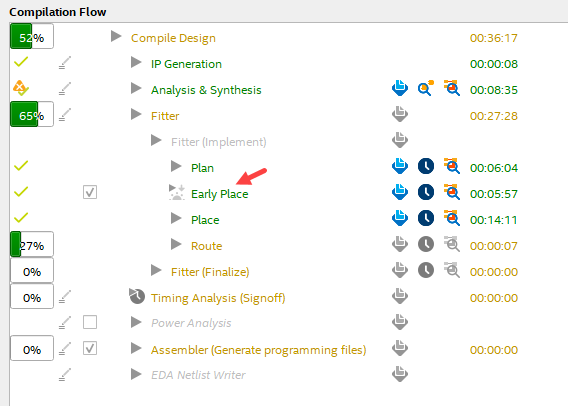

Early Place stage in Quartus flow
As for the Early Place stage in the Quartus flow, when could it be useful?
Thanks!
  • The Early Place feature has been removed from Quartus version 20.1 onward as it is of little value to most users so I don't really recommend to use it.
    Early Place :
    Begins assigning core design logic to device resources. After this stage, the Chip
    Planner can display initial high-level placement of design elements. Use this
    information to guide your floorplanning decisions.
    Start Fitter (Place) :
    Completes assignment of core design logic placement to device resources
    Reference:
    https://people.ece.cornell.edu/land/courses/ece5760/DE1_SOC/qts-qpp-handbook.pdf
    p/s: If any answer from the community or Intel Support are helpful, please feel free to give best answer or rate 9/10 survey.
