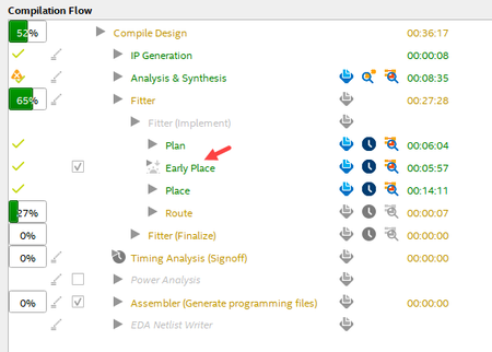

3 years agoEarly Place stage in Quartus flow
As for the Early Place stage in the Quartus flow, when could it be useful?
- 3 years ago
The Early Place feature has been removed from Quartus version 20.1 onward as it is of little value to most users so I don't really recommend to use it.
Early Place :
Begins assigning core design logic to device resources. After this stage, the Chip
Planner can display initial high-level placement of design elements. Use this
information to guide your floorplanning decisions.
Start Fitter (Place) :
Completes assignment of core design logic placement to device resources
Reference:
https://people.ece.cornell.edu/land/courses/ece5760/DE1_SOC/qts-qpp-handbook.pdf
