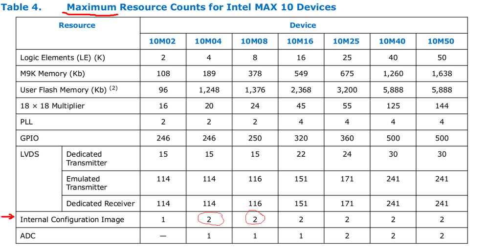

Hi JohnT, I grasped now what is SC , I read thoroughly again document you pointed me to.
Page 6 report difference from compact flash, analog and yes SC just from that are single image.
from table on same page, only 02 seems single image, all other in row are 2 image.
After thinking about page 5 figure 1 part numbering and table 3 I realized table 4 refer to maximum size 0x dependent.
SC if I understood are all single image regardless of LE size.
Thank for clarify this, SA are too much expensive, I try check pinout to see if there where interchangeable in case I need dual image.

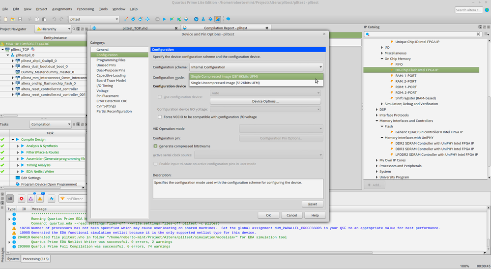

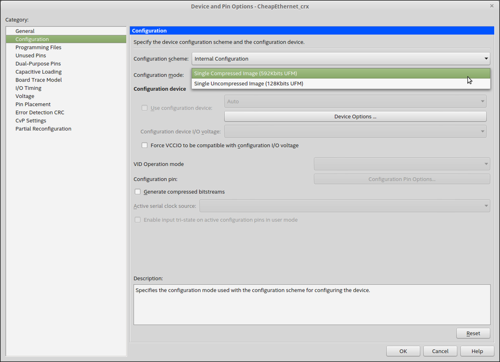

Hi SStrell, I am targeting 04, 08, 16, 25, 50.
128K 592 shown image was 04.
04 to 50 must have dual configuration, changing to large devices just modify the size but don't show as dual configuration.

screenshot for sc50 dual boot and Altera flash Ipcore loaded.
Attached full project, has both single image and PLL configuration issue.
