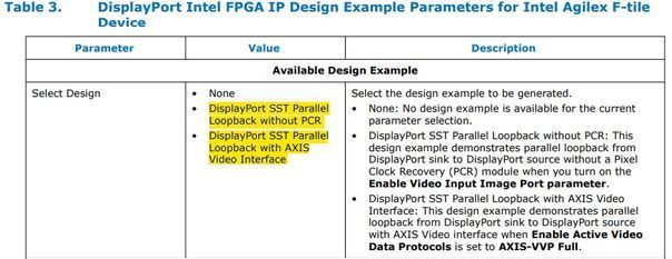

For Agilex device, currently we only have 2 design example available in Quartus software as below:
Table 3. DisplayPort Intel FPGA IP Design Example Parameters for Intel Agilex F-tile Device
For DisplayPort SST Parallel Loopback without PCR design, you are required to turn on the Enable Video Input Image Port parameter to be able to view the design in the "select design" dropdown list under the design example tab.
As for DisplayPort SST Parallel Loopback with AXIS Video Interface, you are required to set Enable Active Video Data Protocols to AXIS-VVP Full for both DisplayPort Sink and Source option in the IP tab to be able to view the design.

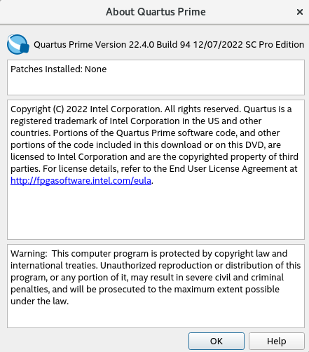

Q2.May I know which OPN and Quartus version that you are using?

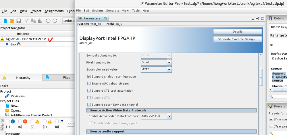

Hi
Q1.Did you enable/turn on the parameter settings as above?
NO cuz I turn-on the AXIS WP
set_global_assignment -name DEVICE AGFB027R31C2E1V
Q3.May I know which design example you are trying to generate?
