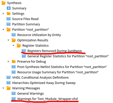

    after running synthesis, should see the .syn.rpt being generated check screenshot attahced.
    Or in GUI, go to compilation report -> Synthesis -> Warning Messages
    compilation report -> Synthesis -> Partition "root_partition" -> Optimization Results -> Register Statistics -> Register Removed During Synthesis
    Check screenshot attached.
