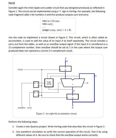

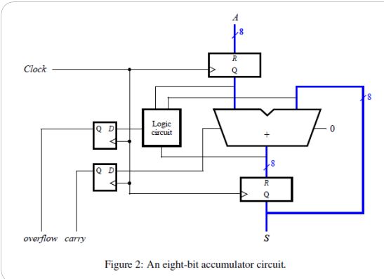

Design Verilog coding for 8-bit accumulator
I have been trying to do the 8-bit accumulator as the picture attached below but can't get the desire waveform. Can anyone help me? Below are the Verilog HDL coding I had done :

      Here is the QAR file. I have provided a full picture and requirements in the picture also.

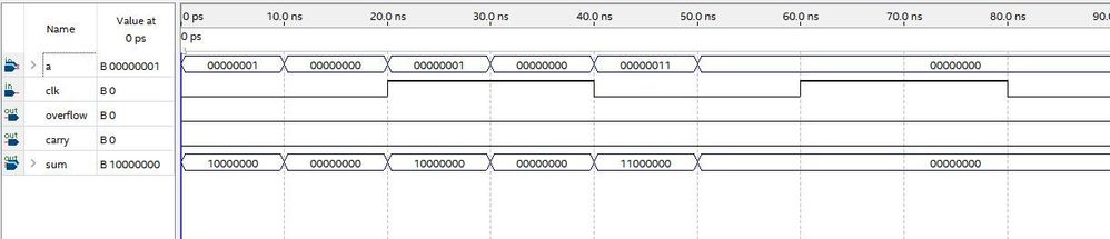

      I didn't do any testbench for this design. But this is the waveform I got.
