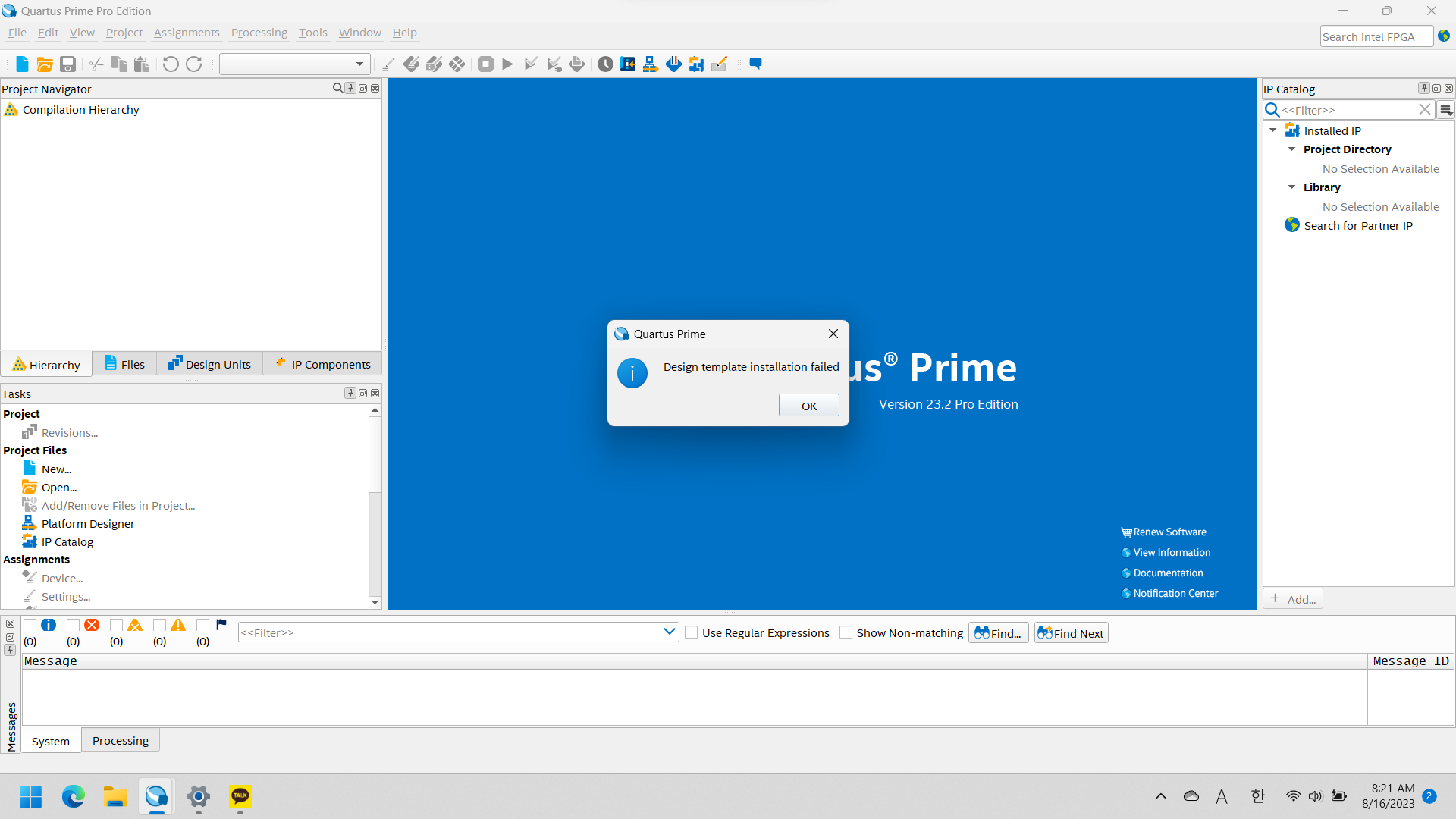

Design template installation failed
Hi all,
I'm trying to run Stratix10_PCIeGen3x8_DMA_18_0.
Whenever I tried to run it, it gave an error message "Design template installation failed".
I had no log message for it, so I couldn't go further.
Is there any ways to check the log message or handle with above issue?
  • Hi,
    The design is version 18.0 based. You have to use version 18.0 Quartus Tool.
    Sheng

      Thank you for reply.
      It was effective and works now.
