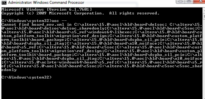

It is very likely that your BSP path is incorrect. Did you look at the getting started guide and configure the paths correctly? There is a chapter on setting up the board for windows in http://www.terasic.com.tw/attachment/archive/836/de1soc_opencl_v02.pdf
