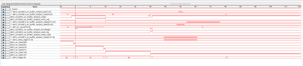

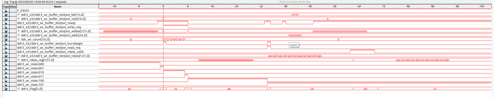

Q1: I configured the Maximum Avalon-MM burst length=1024 of the avalon bus in the DDR3 IP Core. In the actual test, I found that if the read burst length is less than 8 (8 or 4), I can correctly write and Read the data(Fig1), but when the read burst length is greater than 8, the data cannot be read out(Fig2 write burstlength=16,read burstlength =8), in this case, I don't know whether the data is written to DDR3, why does this phenomenon occur? What are the possible reasons?

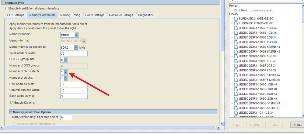

Q2: I used two DDR3 chips, the number of chip selects should choose 1 or 2 ?(Fig3)

Q2: You use chip select of 2.

I don't understand on the Fig 2 that you've shared.
The read burst length = 8 but rdatavalid is not asserted which I think there is no read transaction has performed.
If you set it to 16, what is the error occurred?
