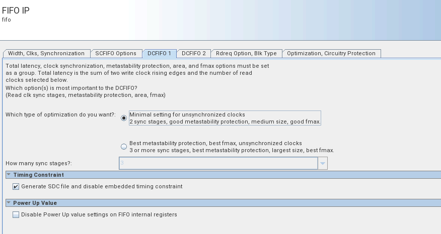

In fifo ip, there's Generate SDC File and disable embedded timing constraint options check below:
Related document: https://docs.altera.com/r/docs/683241/25.1.1/agilextm-7-embedded-memory-user-guide/dcfifo-timing-constraint-setting
Note: Altera recommends that you select this option for high frequency DCFIFO design to achieve timing closure.
- ShengN_altera3 months ago
The related sdc enabled argument is this:
dcfifo_component.lpm_hint = "DISABLE_DCFIFO_EMBEDDED_TIMING_CONSTRAINT=TRUE",
