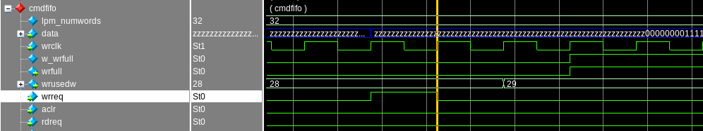

dcfifo full broken
dcfifo #( .intended_device_family ("Agilex"), .lpm_numwords (32), .lpm_showahead ("ON"), .lpm_type ( "dcfifo"), .lpm_width ($bits(t_cmd_data)), .lpm_widthu (6), .add_usedw_msb_bit ("ON"), .read_aclr_synch ("ON"), .write_aclr_synch ("ON"), .rdsync_delaypipe (4), .wrsync_delaypipe (4) ) cmd_dcfifo_i (
full is set 2clocks after a write
full when 29 words are in, whereas the depth is 32

Could you forward the document that explains dcfifo? And tell what's wrong?
All the parameters seem correct. Modelsim and Quartus don't tell me anything about anything wrong.
