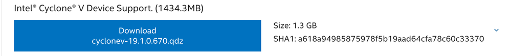

    Note that there is a Cyclone download and a separate Cyclone V download (your message mentions just "cyclone" not "cyclonev"):
    And finally, Quartus, especially back with 19.1, is not officially supported in Windows 11.
  • From the download page,
    https://www.intel.com/content/www/us/en/software-kit/664522/intel-quartus-prime-standard-edition-design-software-version-19-1-for-windows.html
    “cyclone-19.1.0.670.qdz” is for Cyclone IV device, not Cyclone V.
    The correct .qdz file name for cyclone V is “cyclonev-19.1.0.670.qdz”.
