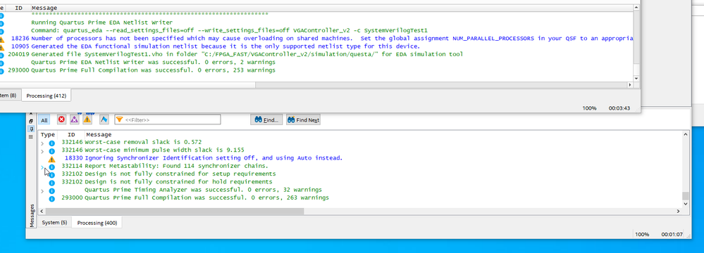

I have just moved from Cyclone IV to Cyclone V development.
I also moved to Quartus Prime 22.1std Build 915 SC Lite Edition to Quartus Prime 20.1.0 Build 711 SJ Lite Edition (not sure if 20.1.0 supports the Cyclone V but I upgraded anyway).
I have noticed that it takes a lot longer to compiler and program the Cyclone V device. This is using the same design as used on the Cyclone IV.
Cyclone IV, Quartus Prime 20.1.0 Build 711: 1 minute 7 seconds
Cyclone V, Quartus Prime 22.1std Build 915: 3 minutes 43 seconds

  • A more complicated larger device is going to require more compile and programming time. You can reduce compile time by adjusting optimization options for the compiler or making sure you are using all the cores of your computer. See the warning message in your screenshot. You can also turn off the running of the EDA netlist writer stage of the compiler unless you need to generate files for a third-party tool.

      @sstrell I just changed the EDA Tool Settings -> Simulation setting to "None" .. and turned off Advanced Physical Optimization.
      The compiler time has dropped to 1:18 !!
      Thanks for the additional hint. This will make such a big difference. I can live with the additional programming time but the 4 minute compile time was a big killer.
