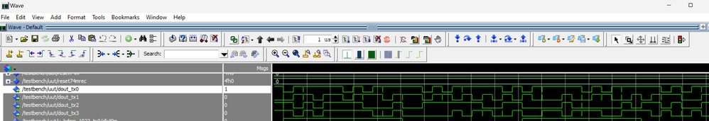

When simulating the ALTGX transceiver Using Questa or Modelsim PE I am seeing glitches on the Tx output waveform. Is this expected? After a rising edge of the data the glitch appears as a narrow pulse 1 serial clock cycle. In the simulation the channel corresponding dout_tx0 has a constant input value.

Can you confirm that you have a local clean reference clock?
Thank you,
Kshitij Goel
- shawn4
Hi K**bleep**ij,
Yes, the reference clock is clean (clk98m_in shown below).
Shawn
- Kshitij_Intel
Is this issue resolved?
Kshitij Goel
- Kshitij_Intel
Hi Shawn,
These are just simulation artifacts, you can ignore them that will not happen in the hardware.
