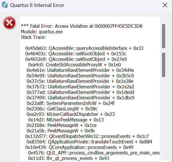

      Unfortunately I got the Fatal Error below. This is the v.13.0.1.232 (sp1)
      I only have Cyclone II device, therefore, I couldn't use new version of Quartus. Kindly advice how to solve this. Thank you.
      • _AK6DN_'s avatar
        _AK6DN_
        You can't use Windows 11 to run such old software as QuartusII 13.0sp1.
        Either find a Windows 10 or Linux box to run it on, or you will need to move to the latest version of Quartus,
        and buy new hardware, as the CycloneII family stopped being supported in 13.0sp1.
