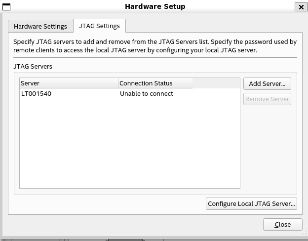

I have a remote PC (OpenSuse) that has Quartus on it.
I want to make it so I can program the FPGA Board that is attached to my local PC (Windows 10 with WSL Debian).

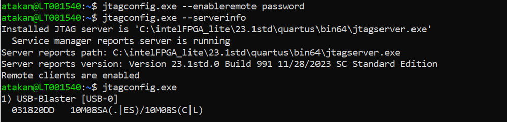

Local PC:
So the JTAG-Server is running on my local server.

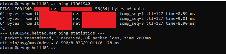

Remote PC:
That means I have connection between these two PCs.
But Im still not able to establish a JTAG connection. I thought that maybe the firewall is blocking the communication so I did
"sudo ufw allow 1309/tcp"
or even "sudo ufw disable"
but nothing worked.
Help would be appreciated.
