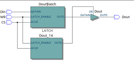

3 years agoConfusion about RTL viewer of Verilog Code: DATAIN of a latch has no connection
I'm a newbie to FPGA design and Quartus ii. I am quite puzzled about the synthesis results of the following code. Here is the code: module sram(Din, CS, WR, Dout);
input CS, WR; // CS: chip selec...

3 years agoHi,
I suggest to look at post-mapping netlist to see the actual implementation.
As far as I understand, the shown code doesn't implement a latch, because Dout isn't necessarily hold with nCS = 1.
