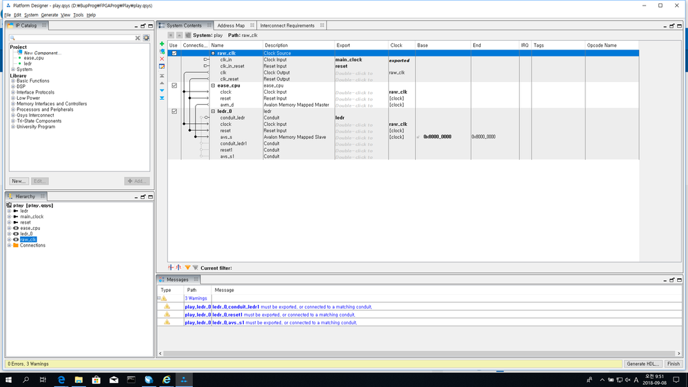

Conduit signal to control external LEDs; some signal has been "copied"

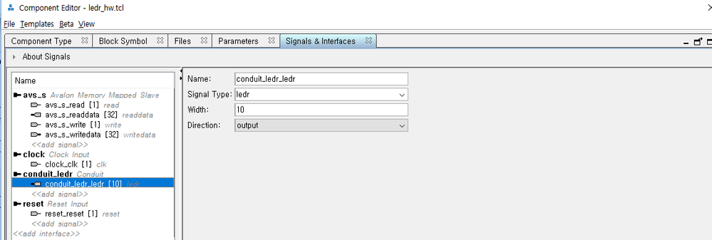

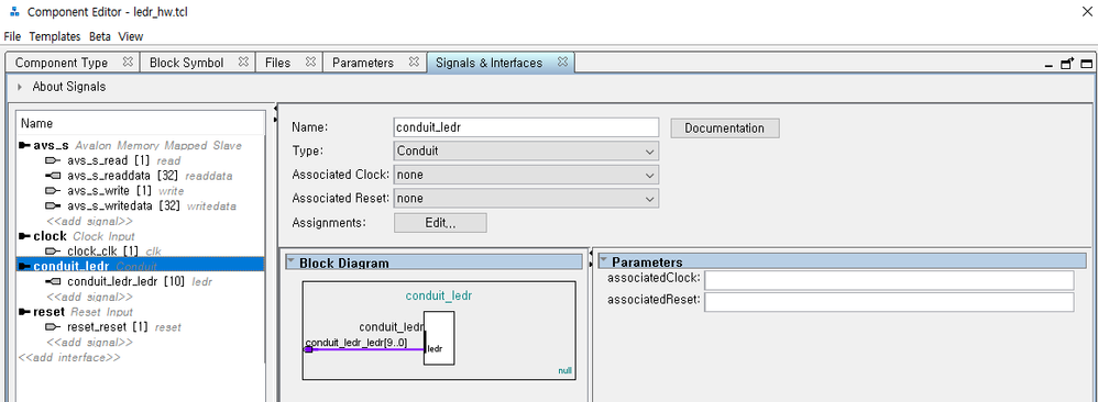

I want to create custom component that controls 10 LEDs on DE10-Lite board.

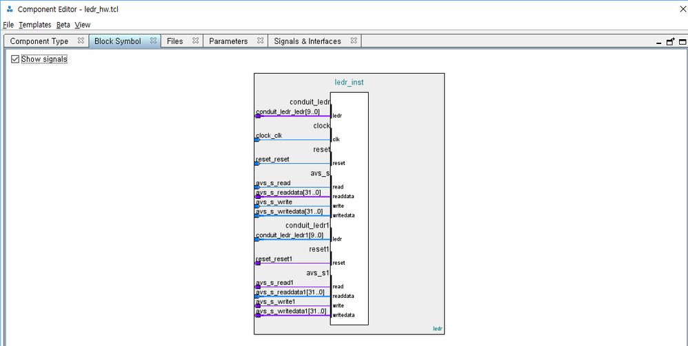

When I tried to create conduit signal named "conduit_ledr" for output, signal named ​"conduit_ledr1" for input suddenly appeared, and there are other signals which seems to be "copied".
Is conduit right thing to control external LEDs? If then, how to remove these "copied" signals? If not, what is the right way to connect LEDs to Platform Designer?
  • Hello Blee15,
    Can you tell us a bit more about what exaclty you are trying to do?
    Is your objective to get a led blinking as a first step or are you looking to make a custom Nios component?
    If you want to make a blinking LED, you can use a PIO (Parallel I/O) component in nios, export the "external connection" ports and then connect these signals to your DE0-LED's in verilog or VHDL where you instantiate your Nios design.

    Thanks for the answer.
    I couldn't find the right component to drive LEDs and/or switches; so, I tried to create new custom component.
    Now, I know that PIO is the right tool to drive them.
