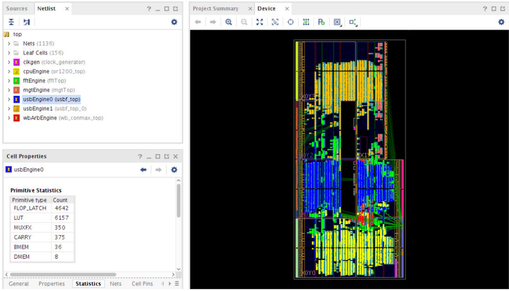

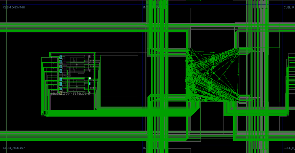

The second screenshot is the Vivado's Chip planner equivalent. It exactly shows the actual resources used by the device and we can even see the routing resources. Surprising how obsolete Intel is, isn't it?
We can even color the resources we want, with different colors: (source: https://www.xilinx.com/content/dam/xilinx/support/documents/sw_manuals/xilinx2021_2/ug906-vivado-design-analysis.pdf)
I'll stop the comparison here, it's too shameful for Intel.

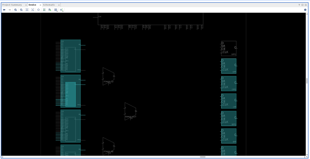

These are two completely different tools. The Chip Planner is used to view device resources and how they are used by your design. You usually use the Chip Planner to analyze the results of place and route to help solve timing issues, but you can also use it to allocate resource usage for a part of the design. If you zoom out the image you posted, you'll see where these resources are physically located on the device.
Your second screenshot is of a schematic editor or RTL viewer, a schematic representation of a design, not the actual resources used by the device. Quartus has a schematic editor and an RTL viewer that are used for a view like this.
