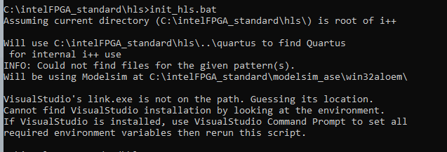

I am using Intel High Level Synthesis compiler with Eclipse IDE. When I run the initialization command
init_hls.bat
I get to see the error "Visual Studio link.exe is not on the path". How can I configure it to use the Eclipse IDE instead of Visual Studio?

    Intel HLS requires Vistual Studio 2015 for compilation. Eclipse is mainly used for Embedded applications targeting NIOS & ARM. GCC toolchain on Windows is used for NIOS and ARM compilation only. If you'd like to use GCC toolchain you will need to use a Linux workstation and the Linux version of Intel Tools.

    Well, some docs suggested that you can configure Eclipse IDE for HLS development.
    https://www.intel.com/content/www/us/en/programmable/documentation/xfy1510159781700.html
    Because, I could not find Microsoft Visual Studio 2010 which was prescribed for Intel Quartus Prime Standard edition in my region. Hence, I installed with Eclipse IDE.
    But, it looks like still I need to use the Visual Studio 2010 edition.
    Please resolve this issue and give a clear answer.

    Well, the document also states that you need Linux to configure and work with Eclipse and HLS . On Windows platform you can only use Visual studio​
