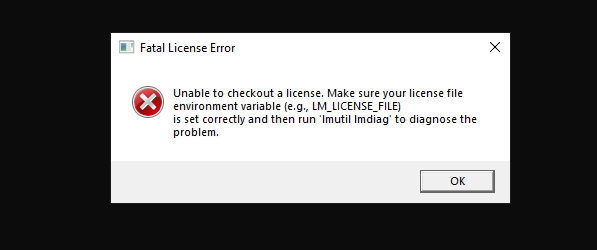

Can't Open Questa, unable to checkout a license
How could I fix this issue?
Already set the LM_LICENSE_FILE.

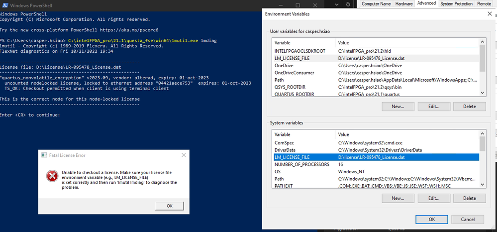

And the lmdiag output as screenshot.

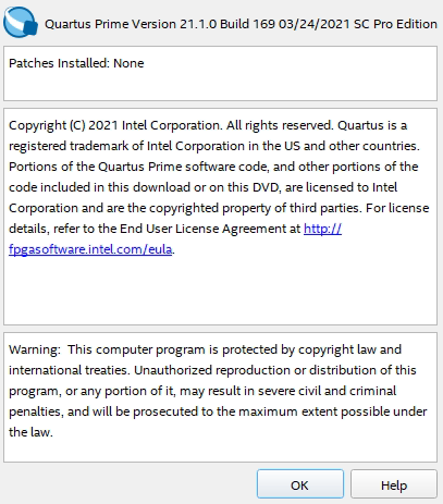

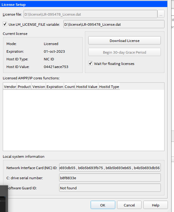

    3) Screenshot of Quartus II>>tools>>license setup

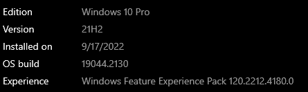

    4) Machine OS information
    5) Quartus version used
