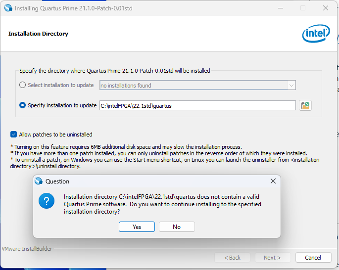

I am trying to update Quartus with this patch:
https://www.intel.com/content/www/us/en/support/programmable/articles/000088789.html
Unfortunately, I am running into a problem with the installer, where the installer cannot automatically locate my installation directory of Quartus, and all attempts at manually locating it have failed, returning the following message:
Where is the Quartus installation directory located?

You may start at the default installation path: https://www.intel.com/content/www/us/en/docs/programmable/683472/21-4/installation-path.html
If that doesn't work, you can follow the below procedure since you are using Windows:
- Search for the Quartus software at the Start Menu
- Right-click and select Open File Location. You have found the installation directory.

I think you have to point to the bin64 directory inside the quartus directory, not the quartus directory itself, since bin64 is where the .exe lives.
