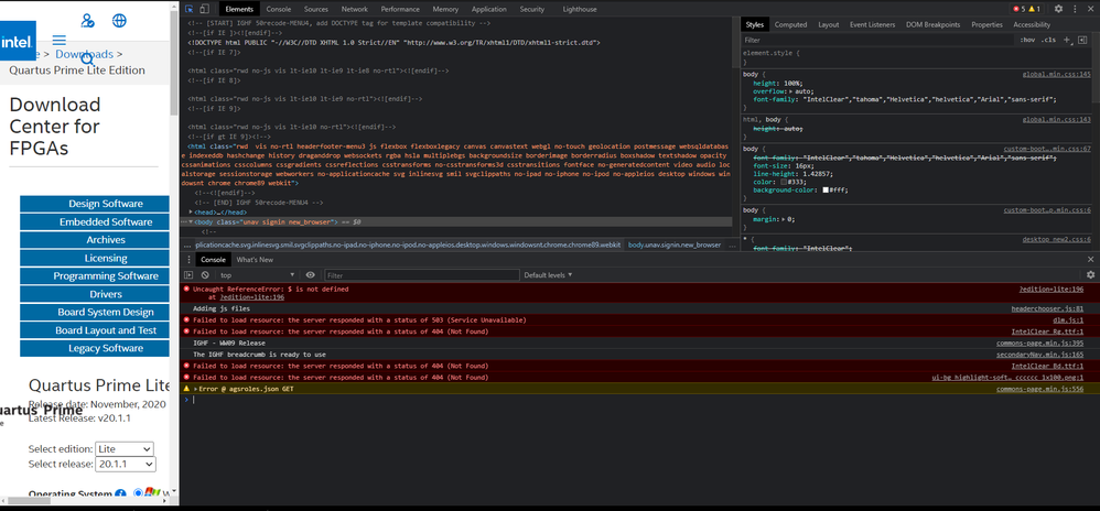

- nickom5 years ago
Thanks Richard,
I tried the chrome dev tools trick and commented out the tracker code, that seemed and was able to download the files, nut having them listed here for one of the version is really useful.
Will intel fix the problem on the webpage. if you can't, maybe a note on the page explaining the workaround would work for people.

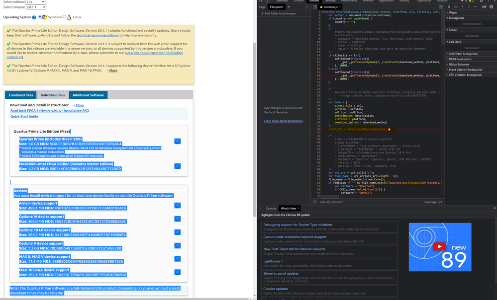

Would to confirm with you on this: when you mention that you used the chrome dev tools trick, does that mean you comment out line 36 of common.js (from the reddit post)? After that, you are able to download the files by clicking the down button in the Intel FPGA Download Page? With you login into your account.Do I understand correctly? If not, could you help to further explain on this? So I could better feedback to the team in fixing this.

When i click on "I Agree" i can see a POST request to https://fpgasoftware.intel.com/api/get_direct_build_file_url/ The response contains a json with the download URL, but the browser for some reason doesn't redirect to it. Can you try it out with the latest version of firefox with "strict" tracking protection? - nickom5 years ago
Hi Richard,
Yes you are correct, as soon as its commented out the download link (arrow works fine)

Follow the instruction in this link:
https://www.reddit.com/r/FPGA/comments/igmbcd/intel_quartus_download_link_broken/
once you save the changes you can then download the files (need to be logged in of course) Bear in mind if you refresh or reload the page it wont work.

Need some help from you. Could you help to share the screenshot on what is shown in the webpage when you open the Chrome dev tools? Possible to add a screenshot on the exact comment line that you have changed? This is for the engineer team to analyze the issue.
Example below should be good enough.
Thank you in advance for the help.
Shyan Yew (Richard) - nickom5 years ago
Here you go, line 36 you will see I have commented out
wap_tms.custom.trackDownload(data);
