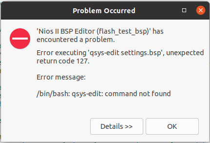

> I have installed Quartus version 23.2 and Eclipse IDE into the Ubuntu 20.4 system.
https://www.terasic.com.tw/wiki/Getting_Start_Install_Eclipse_IDE_into_Nios_EDS
> I have loaded the FPGA file .sof into the eclipse IDE & generated the "Nios II application & BSP from template".
> I have used "Memory Test" as a template, to generate the project.
> I clicked the Nios II ---> BSP editor option & the BSP editor didn't open, instead it showed an error.
Can anyone help me to solve the issue? Thanks in advance.

- EBERLAZARE_I_Intel
Can you provide the full Quartus version that you're using? Is it the Pro version?
- Anu_Jayan
Yes, I am using Intel Quartus Prime Version 23.2.0 Build 94 06/14/2023 SC Pro Edition.
Anu Jayan
For Quartus 23.2, the Nios® II Processor and Nios® II Embedded Design Suite products are deprecated and will be removed in a future release.
