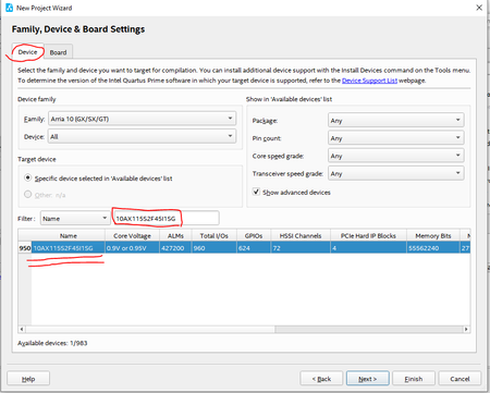

3 years agoBoard isn't visible in Quartus
Hello, I own an Arria 10 DK-DEV-10AX115S-A board with a 10AX115S2F45I1SG FPGA on it. I installed Quartus 19.4 Pro and I'm able to find the 10AX115S2F45I1SG under the "Device" table in the "New Proj...

That's not for Quartus. That's documentation about a board itself. Like I said, you have to go to the design store using the link in the New Project Wizard, not the board product page: https://www.intel.com/content/www/us/en/support/programmable/support-resources/design-examples/design-store.html

3 years agoThis is the link for design example.
You may find the board support here.
