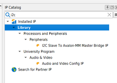

Our group of Quartus users has encountered some scenarios where the "Avalon I2C (Master) IP" is missing from the IP Catalog of Quartus 26.1 on Windows machines.
It is working well on other Windows machines and Linux machines in the same network.
A Windows machine missing the IP:

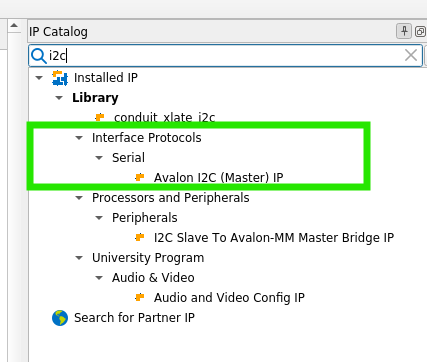

 A Linux machine where it works;
Installing Patch 0.11 did not solve the issue.
All relevant environment variables seem to be equal on both working and non-working machines.
Any ideas?
  • I had checked the internal bug ticket. The fixing is planned in v26.3. Currently please stick with platform designer as workaround
