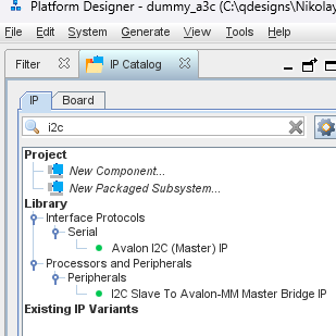

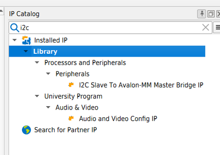

3 months ago"Avalon I2C (Master) IP" is missing from IP Catalog on some 26.1 installations
Our group of Quartus users has encountered some scenarios where the "Avalon I2C (Master) IP" is missing from the IP Catalog of Quartus 26.1 on Windows machines. It is working well on other Windows m...

Turning off security software is not an option on corporate laptops.There has been an APS case where a workaround is to use Platform Designer instead. It shows up there on my computer in this case.
