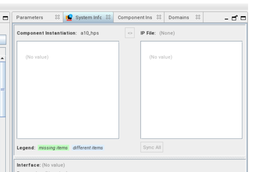

Arria10 HPS IP File missing
Sorry for the delay in response as I just got back to office, I tested on Quartus Pro Linux 25.1.1, 25.1 , 24.3, 23.3 and I can see the same behavior whereby IP file is listed as none for Arria 10.
I checked our internal database and saw there was a case note that mentions Arria 10 altera_arria10_hps ships the HPS content as .qsys hardware project file instead of .ip file (similar to older devices eg. Cyclone V). For newer devices such as Stratix 10 , Agilex 7 onwards, the approach is to ship the HPS as a modular IP component with separate HPS IP releases for Platform Designer instantiation.
Just FYI , there is Arria 10 GSRD user guide on generating the gsrd and other files
Note: for gsrd, the repo https://github.com/altera-opensource/gsrd-socfpga is no longer updated after 24.3, the new repo is this https://github.com/altera-fpga/arria10-ed-gsrd
(will be updated in the document)
Also discussed with our factory team to confirm that the warning(Warning message :- “Warning: File path could not be determined for component altera_arria10_hps in xxx.qsys. The component is ignored for generation.") could be safely ignored.
Anyway, I noticed that by disabling the Parallel IP generation, it will remove the warning message on the File path could not be determined.
