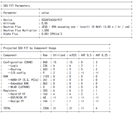

1 hour agoAbout Single Event Upset (SEU)
The target devices are MAX 10, Cyclone 10 LP, Cyclone V, and Agilex 3. I would like to confirm the details about SEU for these devices. Question 1: Please explain how the FIT value shown in the...
