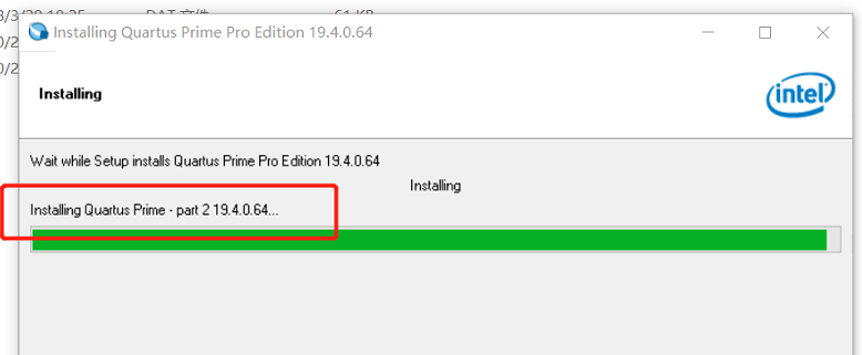

6 years ago请问我下载的 pro 19.4 为什么一直无法安装成功?一直卡在这个状态。持续了几个小时都是这个状态。
- RichardT_altera
Hi could you temporarily disable your antivirus while Quartus install?
May I know which OS platform (Window/ Linux) are you using?
- RichardT_altera
HI do you able to install the quartus pro version 19.4 with the antivirus disabled?
- DXu2
目前我们已经基本确认了,下载整体安装包,可以正常安装。下载独立文件,安装,会出现卡死的现象。
