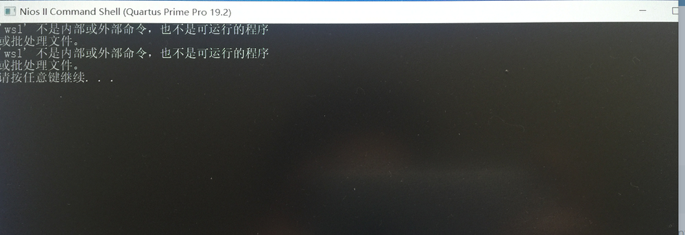

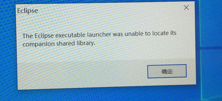

window10 Quartus pro 19.2 软件nio2 command shell 无法启动?
我下载的文件:eclipse-cpp-2019-06-R-win32-x86_64
我的安装指令:
  1. Extract the downloaded file into this directory: < Intel® Quartus® Prime installation directory>/nios2eds/bin. You should see the < Intel® Quartus® Prime installation directory>/nios2eds/bin/eclipse folder after extraction is done.
  2. Rename the < Intel® Quartus® Prime installation directory>/nios2eds/bin/eclipse folder to < Intel® Quartus® Prime installation directory>/nios2eds/bin/eclipse_nios2.
  3. Extract < Intel® Quartus® Prime installation directory>/nios2eds/bin/eclipse_nios2_plugins.zip for Windows or < Intel® Quartus® Prime installation directory>/nios2eds/bin/eclipse_nios2_plugins.tar.gz for Linux* to < Intel® Quartus® Prime installation directory>/nios2eds/bin. The extraction overrides files in < Intel® Quartus® Prime installation directory>/nios2eds/bin/eclipse_nios2.
  4. Verify the extraction is done correctly by making sure you see the < Intel® Quartus® Prime installation directory>/nios2eds/bin/eclipse_nios2/plugin_customization.ini file.
  5. You can now launch Nios® II SBT for Eclipse using eclipse-nios2.exe.
确定上面5步没有问题​
结果:
10 Replies
  • MEIYAN_L_Intel's avatar
    MEIYAN_L_Intel
    Its seems the error is same as thsi forum:
    https://forums.intel.com/s/question/0D50P00004NtxB8SAJ/quartus-prime-pro-192-nios-ii-command-shell-and-nios-ii-sbt-for-eclipse-are-not-working-under-windows-10-pro-1903
    I had with ticket: 1507321697 as mentioned in this forum, the developer is still investigating this problem.
    Could you try to install "Quartus from the installation 19.2 and the Nios II SBT from the installation 18.1"?

    Could you try the steps as below:
    1. Window search> turn window features on or off> enable Window Subsystem for Linux
    2. Restart the computer
    3. Go to Microsoft Store install -Ubuntu
    4. Open Ubuntu and type the following command:
    -sudo apt install wsl
    -sudo apt install make
    -sudo apt install dos2unix
    For more information, you may need to chapter 2.1 in link below:
    https://www.intel.com/content/dam/www/programmable/us/en/pdfs/literature/hb/nios2/n2sw_nii5v2gen2.pdf
