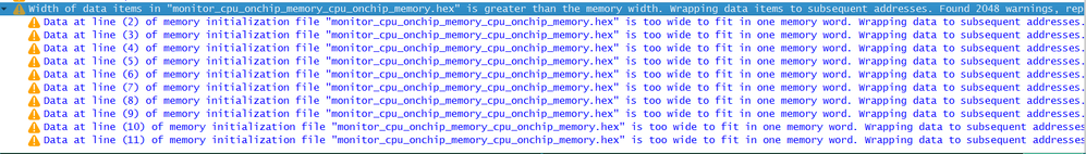

Quartus report warings:

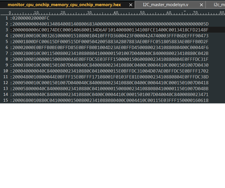

When I opened the hex file generated, I found that it was not in the right format:
