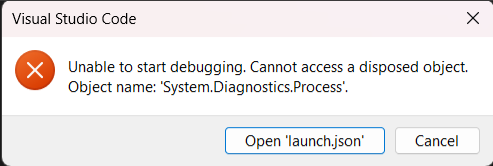

The standing issue now lies in the Debugging component of Ashling RiscFree.We have, in fact, tried two different approaches:
- using Ashling RiscFree IDE v23.1 as our debugging medium
we get the error "selected debug probe is not available for debug session"
- using the Ashling RiscFree extension for VS Code instead
Both approaches have been failing us, that's why I am attaching a couple screenshots above of error messages we have been receiving.

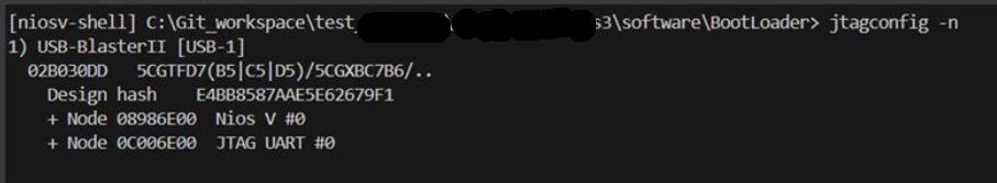

This is what the jtagconfig launched from our NiosV-Shell is reporting us:
I have started wondering about user access/ user permissions in regards to these new errors popping up: have there been any previous reports of access limitations caused by lackluster user privileges or user permissions?
