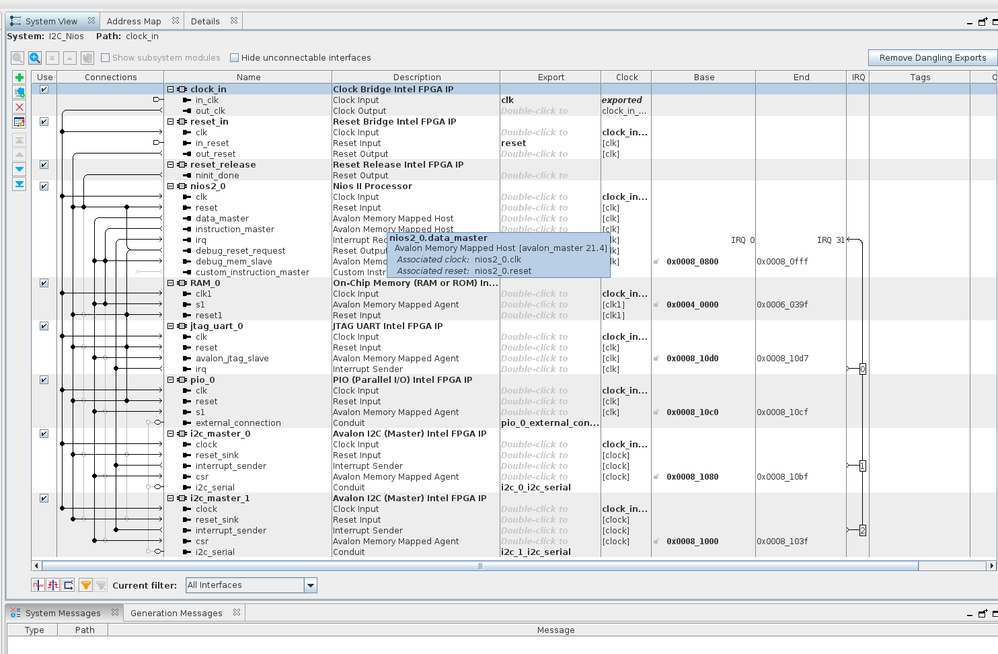

Please see the attached screen shots. They will show you the error, my C code, my Qsys environment, my HDL, the type of device. Everything.

    So, here is my Qsys in case anyone else needs help setting this up:

    I took a look at your qsys design screenshot, is it possible if you connect the reset of other IP to the "Reset Relese IntelFPGA IP"?
