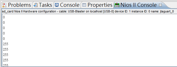

"I am currently using Python to convert images to text, and in Eclipse, I am able to perform Sobel operations on the text data. I have successfully converted the results back into images using Python for validation. However, I am facing an issue on how to save the Sobel-processed results back to the SD card.
The input image is 100x100, resulting in 10,000 data points. I have tried writing the data back to the SD card from the Nios console, but I can only successfully save approximately 752 records. After that, the data becomes corrupted. How can I overcome this issue?"

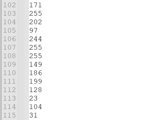

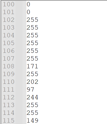

"And there are also some errors in the values. For example, the 102nd data point should be 171, but it is recorded as 255."
Nios ii console
txt file

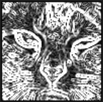

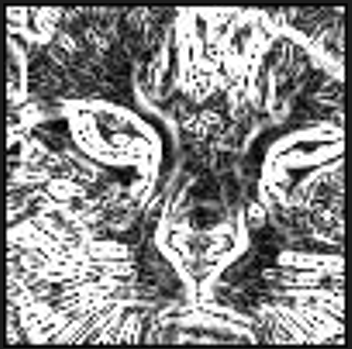

This time, I will attach the results of the Sobel operation. I used Python to convert the text file to PNG for observation. Since I haven't been able to successfully write back to the SD card yet, I manually copied the results from the Nios II Console.
Original:
I have included the code for writing back to the SD card.
result image:
no writing back to the SD card.
result image:
It's intriguing that after adding the code to write back to the SD card, the Sobel results differ. Removing that part seems to restore the original Sobel outcomes. Currently, I am unable to resolve the issue of not being able to write all Sobel results to the SD card at once, managing to successfully write back only 769 sets of data.
The Sobel results seem to be relatively consistent, with no apparent differences.
#include <stdio.h> #include <stdlib.h> #include <string.h> #include <math.h> #include <altera_up_sd_card_avalon_interface.h> #define WIDTH 100 #define HEIGHT 100 // 3x3 Sobel operators for gradient calculation int sobel_x[3][3] = {{-1, 0, 1}, {-2, 0, 2}, {-1, 0, 1}}; int sobel_y[3][3] = {{-1, -2, -1}, {0, 0, 0}, {1, 2, 1}}; void applySobel(short int* imageData, unsigned char* resultData) { memset(resultData, 0, WIDTH * HEIGHT); for (int y = 1; y < HEIGHT - 1; y++) { for (int x = 1; x < WIDTH - 1; x++) { int gx = 0, gy = 0; // Convolution with Sobel operators for (int i = -1; i <= 1; i++) { for (int j = -1; j <= 1; j++) { int pixelValue = imageData[(y + i) * WIDTH + (x + j)]; gx += sobel_x[i + 1][j + 1] * pixelValue; gy += sobel_y[i + 1][j + 1] * pixelValue; } } // Calculate gradient magnitude int magnitude = (int)sqrt((double)(gx * gx + gy * gy)); // Clamp magnitude to 0-255 magnitude = (magnitude > 255) ? 255 : ((magnitude < 0) ? 0 : magnitude); resultData[y * WIDTH + x] = (unsigned char)magnitude; } } } int main() { short int sd_fileh,sd_fileh2; alt_up_sd_card_dev *sd_card_dev = alt_up_sd_card_open_dev(ALTERA_UP_SD_CARD_AVALON_INTERFACE_0_NAME); if (sd_card_dev != 0 && alt_up_sd_card_is_Present() && alt_up_sd_card_is_FAT16()) { sd_fileh = alt_up_sd_card_fopen("test8.txt", false); if (sd_fileh >= 0) { short int imageData[WIDTH * HEIGHT]; unsigned char resultData[WIDTH * HEIGHT]; printf("Reading data from test8.txt:\n"); // Read image data into the array for (int i = 0; i < WIDTH * HEIGHT; i++) { char buffer[10]; int j; for (j = 0; j < 4; j++) { // 根據你的像素值調整大小 char currentChar = alt_up_sd_card_read(sd_fileh); if (currentChar == -1 || currentChar == '\n') { break; // 到達檔案結尾或換行字元 } buffer[j] = currentChar; } if (j == 0) { break; } buffer[j] = '\0'; printf("%s\n", buffer); imageData[i] = atoi(buffer); } // Apply Sobel operator to the image data applySobel(imageData, resultData); // Print the Sobel operation result printf("Sobel operation result:\n"); for (int i = 0; i < WIDTH * HEIGHT; i++) { printf("%d\n", resultData[i]); } // Close the original file alt_up_sd_card_fclose(sd_fileh); // // Create and write the result to test11.txt // sd_fileh2 = alt_up_sd_card_fopen("test11.txt", true); // if (sd_fileh2 >= 0) { // for (int i = 0; i < WIDTH * HEIGHT; i++) { // char buffer[10]; // sprintf(buffer, "%d\n", resultData[i]); // alt_up_sd_card_write(sd_fileh2, buffer); // } // alt_up_sd_card_fclose(sd_fileh2); // printf("Sobel result written to test11.txt\n"); // } else { // printf("Problem opening or writing to file. Error %i\n", sd_fileh); // } // // // Close the original file // alt_up_sd_card_fclose(sd_fileh2); } else { printf("Problem opening file. Error %i\n", sd_fileh); } } else { printf("SD card not available or not in FAT16 format\n"); } return 0; }- CK1143
I have identified the issue with the different results in Sobel. I found that the lines of code 'char buffer[10];' and 'sprintf(buffer, "%d\n", resultData[i]);' are the main culprits.
