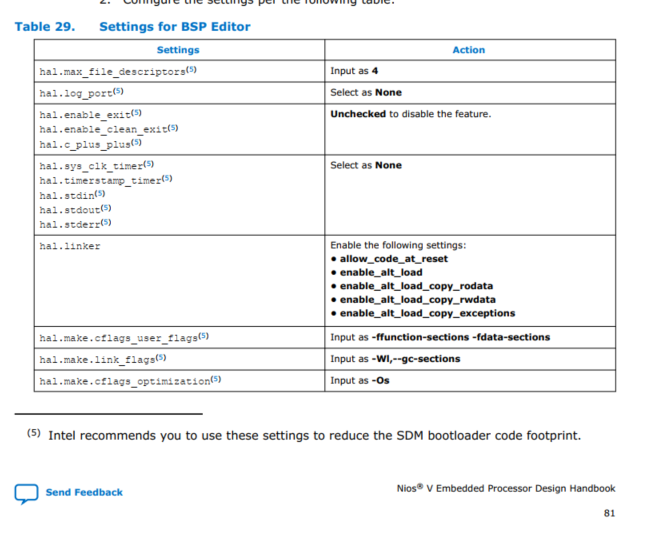

This is from the NiosV Embedded Processor Design Handbook on page 81.

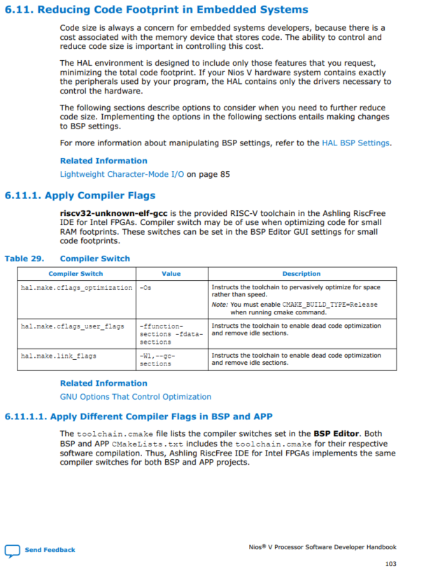

This is from the NiosV Processor Software Developer Handbook on page 103.

For more information, I looked at the sw/app/CMakeLists.txt and realized it does include "include(../bsp/toolchain.cmake)." Correct me if I am wrong, but this makes me believe that adding optimization on the bsp also optimizes the app code?

Yes, adding optimization on the bsp also optimizes the app code.

It seems you need to download the latest version of the NiosV Embedded Processor Design Handbook to be able to see the part of the code footprint. Will attached below the part of the book which I refer to the downloaded version.
At the same time, you also can refer to the NiosV Processor Software Developer Handbook on this part.
