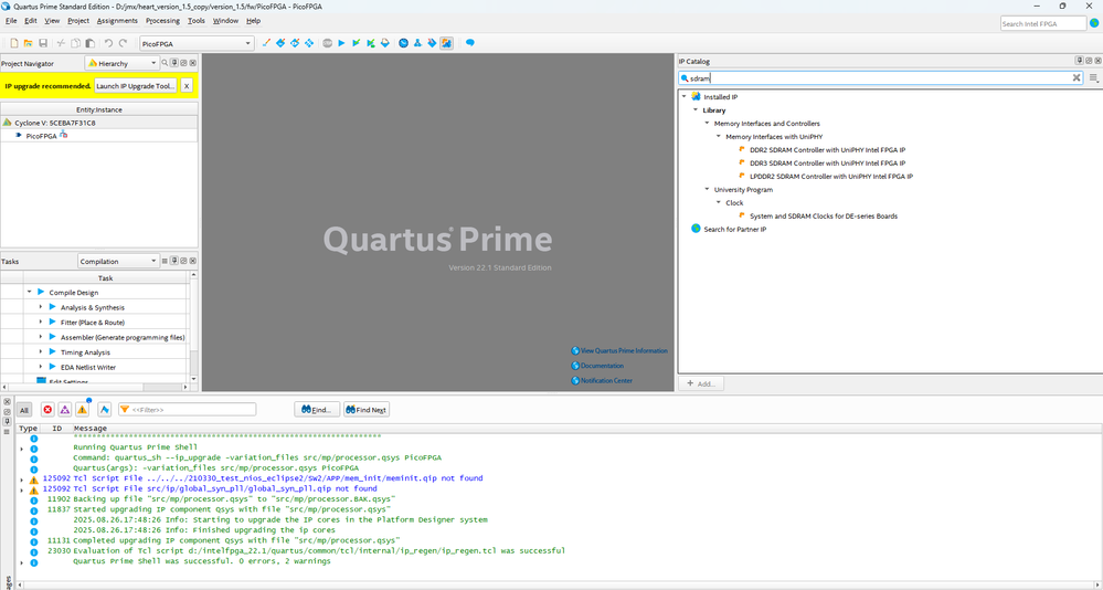

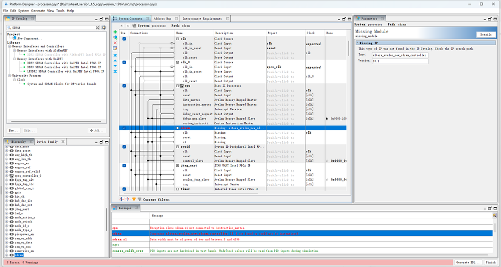

    I have installed Quartus Prime 22.1 Standard, but I still cannot find the IP altera_avalon_new_sdram_controller in the IP Catalog as you can see on the right side of Fig1. Meanwhile, this IP still appears as Missing when I open a .qsys file that contains it (Fig2).
    Could you please advise how to properly enable or locate this IP in Quartus 22.1 Standard? Thank you so much!

      I checked my 22.1 installation and found that altera_avalon_new_sdram_controller IP was apparently automatically copied from 19.1 IP folder when importing a 19.1 design.
      After being imported once, it's listed regularly in Platform Designer.
