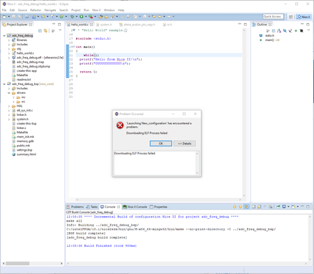

Quartus Programmer works but Eclipse Flash Programmer doesn't work
The Nios II processor and other IPs typically expect a stable internal FPGA clock. A raw external crystal (not a clock module) needs a PLL or oscillator circuit to become a usable internal clock. Without a PLL, the Nios system might not run, hence causing the “Target is broken” error.
Fix:
Add a PLL (ALTPLL) in Platform Designer and configure it:
Input: 40 MHz
Output: a stable clock (e.g., 50 MHz or 100 MHz)
Connect this to the clock input of your Nios II system
Then regenerate the system and recompile your project.
Even if you have a clock input connected, if the FPGA fabric doesn't receive a valid toggling signal, Nios II won't start.
Test:
Add a blinking LED logic driven by the same clock to verify the FPGA "sees" a running clock.
Or use a SignalTap logic analyzer to probe clock toggling internally.
Run Quartus -> Tools -> System Console, then:
tcl, jtagconfig
bash, nios2-terminal
If the Nios II does not respond, it's likely not clocking or reset properly.
Verify:
reset_n to the Nios II and other peripherals is correctly connected
You’ve added a reset controller in Platform Designer
The reset source is active-low and held long enough during power-up
After regenerating Platform Designer system:
Go to Eclipse: Right click the BSP → Regenerate BSP
Clean and build the ELF file again
Then try to flash
Sometimes the Flash Programmer fails due to:
Missing or incorrect Flash controller connection
Try using Run → External Tools → Nios II Flash Programmer instead of Run Configuration
