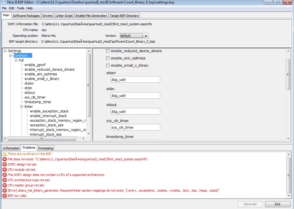

I have build an SOPC system using Quartus 11.1. The system has an on-chip ram. Now, I am using NIOS II - Eclipse platform to build the application. I choose "New NIOS II Application and BSP from template". After adding my SOPC Information file and so far its ok.
Eclipse created two elements at the left side of the panel but no the altera.components.
When i go to the BSP properties, i can see some errors:
-There are no Drivers in this BSP.
-File Does not exist C:..\nombre_sopc_project.sopcinfo.
-SOPC design no set.
-CPU module no set.
-The SOPC design does not contain a CPU of a supported architecture.
-CPU architecture type no set.
-[Error] altera_hal_linkerx_generator: Required linker section mappings do not exist: "[.entry, . exceptions, .rodata, .rwdata, .text, .bss, .heap, .stack]"
-BSP not valid.
Or in the attachment.
I really appreciate your help.

    Hey man, i have same problem with my project, i'm newbie with NIOS II systems. How do you do to solve this problem?

    You must add the onchip memory for loading the program. Try this.
