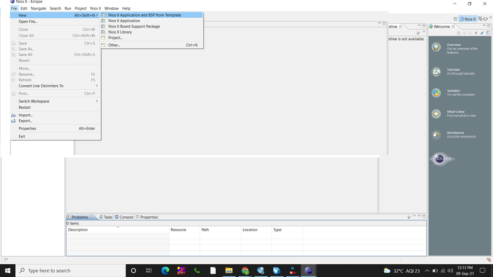

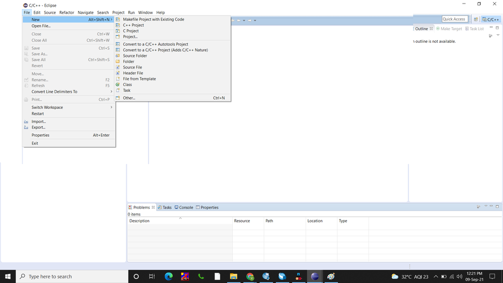

i am working on the Quartus prime lite 20.1 version on windows 10 platform,issue is that when i am trying lunch to nios iieclipse after completion of niosii design , i am getting normal c/c++ eclipse platform as shown in below
figure.
i am not getting niosii eclipse environment as shown below , let me known did any one faced this issue what is the reason & any solution for it as soon as possible,
i tried with 19.1 version also the niosii eclipse could not respond and did not opened the as shown in the above figure
  • Hi,
    You can open Windows, and search for Nios II Software Build Tools for Eclipse.
