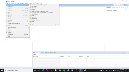

problem with nios ii software builder tool for eclipse importing tool issue

Hi raviganesh,
thank you for your valuable information on this issue.i have resolved the issue , and strucked with some other issue in eclipse
